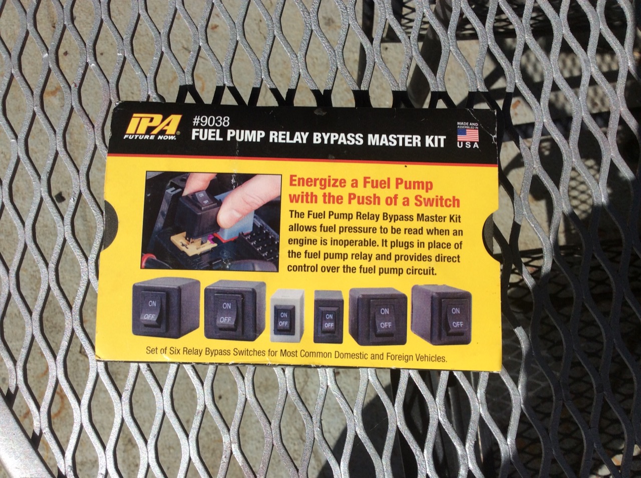

well hooked up a pressure gauge and the fuel pump on it went to 56 psi so i know it flows fuel.
