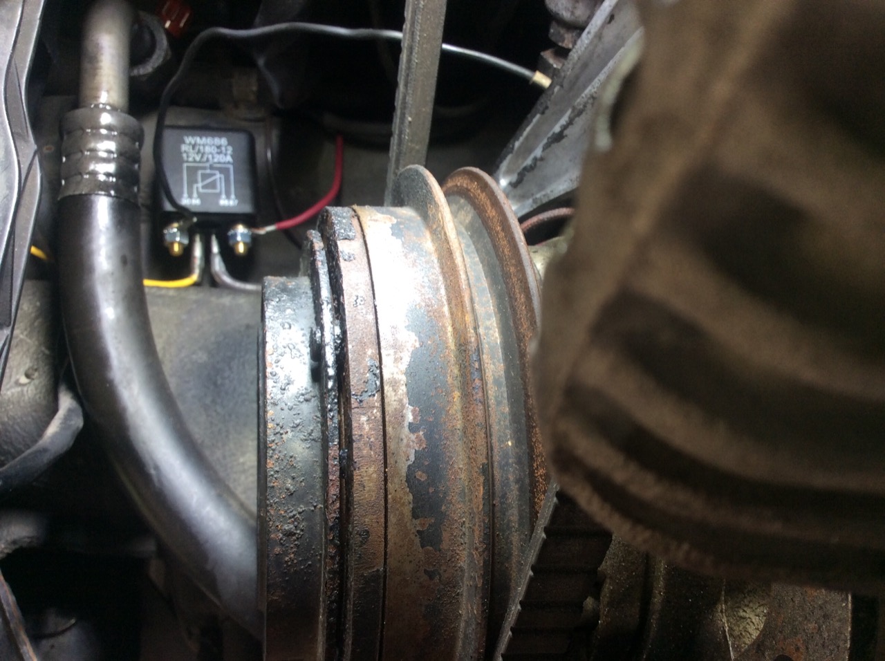

Update, Rich rebuilt ECU and MAF, put them in and pulled every relay and fuse and shot contact cleaner in each slot, one at a time. Car ran fine for three weeks. So started to work on the AC system, hot wire clutch and it worked, was able to charge the system. Then kept trouble shooting the system, Kevin in Atlanta gave me the checks for connections compressor to control. My #9 pin wire from low pressure switch(LPS) is bad (broken in harness?) but I have power to the LPS so I put a relay under the starter post to get high power to the clutch. This now checks good but after this work the car would not start! Will run on starter fluid so pulled the ECU and Rich just checked it and tested it in his 87 and it’s good. Jumped fuel pump relay can hear the pump running, so while trying to check the AC wiring I must have bumped some thing to cause this. All grounds have been cleaned and tightened. Suggestions? Will get ECU back in a few days.
Dan . AC clutch relay.

The 14 pin connector was intact and I removed each relay one at a time and used the contact cleaner also each fuse one at a time. The only relay I have added is the one for the compressor clutch.
