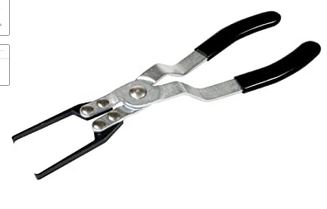

Relay puller pliers are a must for the 928 owner. They can be difficult to remove and can be damaged, or the relay socket can be damaged if improperly yanked.
Lisle 46950 Relay Puller Pliers are what I purchased and recommend.

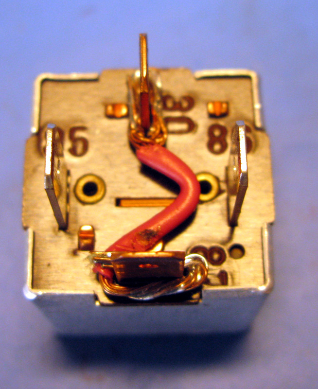

I use an old relay as a jumper, I wrap a wire around the relay pin 30 (always has 12V) and 87 (switched output) ... so this bypasses the switching function of the relay and becomes the jumper.
As Stepson noted, remove the jumper immediately after the test as the circuit remains powered when the jumper is in place. I keep this jumpered relay in my glove box so I always can always make a quick jump check if needed.
