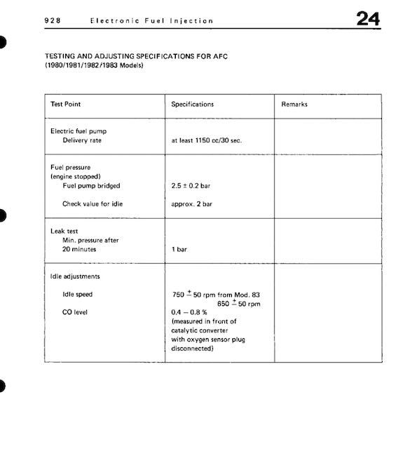

Jan,
I'm only familiar with my '79 KJET CIS system. Is your '82 this system too? Somewhere it went to LJET, but I'm not sure when.
If it is KJET, then it is all pressure controlled.
I think that your '82 is a KJET CIS (continuous flow) like mine. Anyway, here are some specs for '82's from the Workshop Manual.
The easiest spec to check is the fuel delivery flow rate. This specs assumes that the fuel filter is good and no that there are no flow obstructions.
The fuel filter is, of course, another potential problem source.
Don't know what brand pump you got, but I went with Bosch when I refurbished my system.
Here's another reference that you might find useful.
