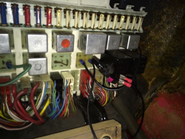

You sure seem to be on the right track! If 12 volts does not energize the pump, it’s dead! There is a safety system that shuts off power to the pump when the engine is not running. On start up, the pump has power when you are cranking the engine over and for about a second after you stop cranking. If the car started, then the pump stays on. So if the car is not starting, unless you are able to see the voltage when you are cranking, you may be getting voltage at the pump for just the short time that you crank. I’m with you, a new pump is probably the answer. Since you have identified the pump relay, I've attached a picture of the terminals to jump so that you can send voltage to the pump without having to crank. I found that jumping these terminals was very useful when diagnosing fuel delivery problems like you have.
I’m sorry that the link didn’t work. It’s a good site to use to see parts and to get part numbers. See if you can type in just through the /porsche-parts/ part of the address.
The black wires form my jumper in the fuel relay socket. I used a switch for this one, but the switch is not necessary.
