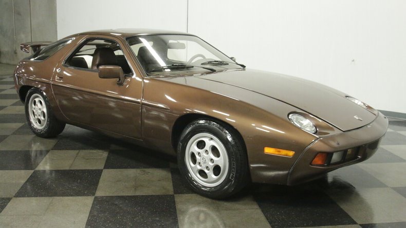

At this time, I'm trying to get the car up "For Sale" . I can't wait 3 months and am willing to reduce the price so the next Owner can address this issue.
I'm always open with Buyers on issues. Maybe too honest for my own good, but it's the right thing.
I hate having to sell it, but personal finances are entering into the mix, and She's gotta go.
Feels like a bad divorce to me, She's fighting me every step of the way.
The Car only has 46,000 miles on Her and She's definitely a looker.
