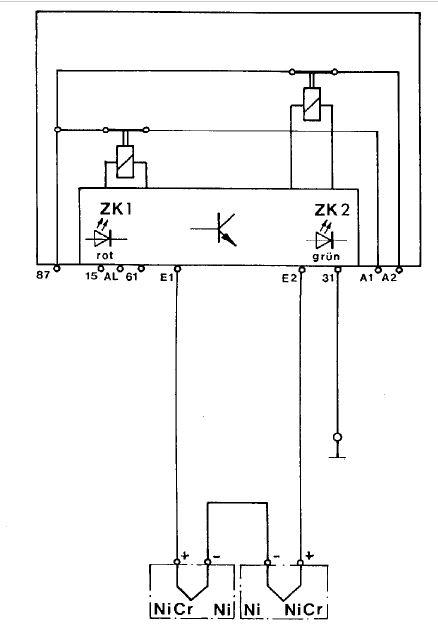

Question: How can identical electronic components in series detect which is active or malfunctioning? Identifying the ignition systems as left and right only is useful because they are physically located there, each one fires TWO CYLINDERS ON EACH BANK, so how can temperature sensors tell which one is faulty? If you can find the time to reply again PLEASE address these questions!
Answer: Information from the Porsche Service Info Tech 1989 manual is a great source!
Thermo Element
Two wires made of different metals (nickle-chrome and nickle) are welded together on one end. If the point of connection is heated, electric voltage (thermo voltage) is produced. The amount of voltage depends on the thermically effective wire length (I), the materials of wires and the applied temperature.
Basically it concerns very low voltage, which is in a range of 4 mV for each 100C difference in temperature.

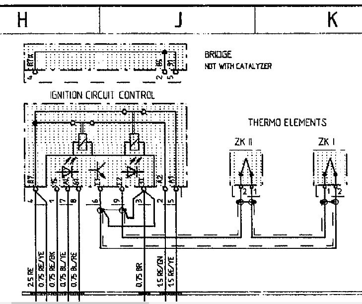

Schematic of connection
Look to the schematic, the Thermo Elements ZKI and ZKII have termials 1 and 2. The wiring is that the terminal 2 is the shielded signal input:
ZKI terminal 2 connects to Ignition Control circuit pin 6
ZKII Terminal 2 connects to Ignition Control circuit Pin 9

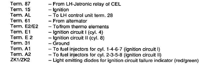

Terminals El and E2 of the ignition circuit monitoring relay will each have the same voltage after starting the engine and heating-up of thermo elements (with perfect condition ignition circuits).
If one ignition circuit would fail and the exhaust temperature drops, there would be less voltage on the pertinent terminal (El or E2), depending on which ignition circuit has failed. This difference in voltage will be recognized by the ignition circuit monitoring relay.
A relay contact in the relay belonging to the failed ignition circuit is opened and interrupts the supply of power to the fuel injectors of this ignition circuit. One of two colored light emitting diodes in the relay lights up at the same time.
It is easy to recognize which ignition or injection circuit is concerned when an injection circuit is
switched off because of the different colored light emitting diodes and transparent relay housing.
Red LED: Ignition Circuit I
Green LED: Ignition Circuit II
The relay switches off fuel injection as from a voltage difference of 6 mV, which is equal to a difference in temperature of about 150C.
Thermo Element
