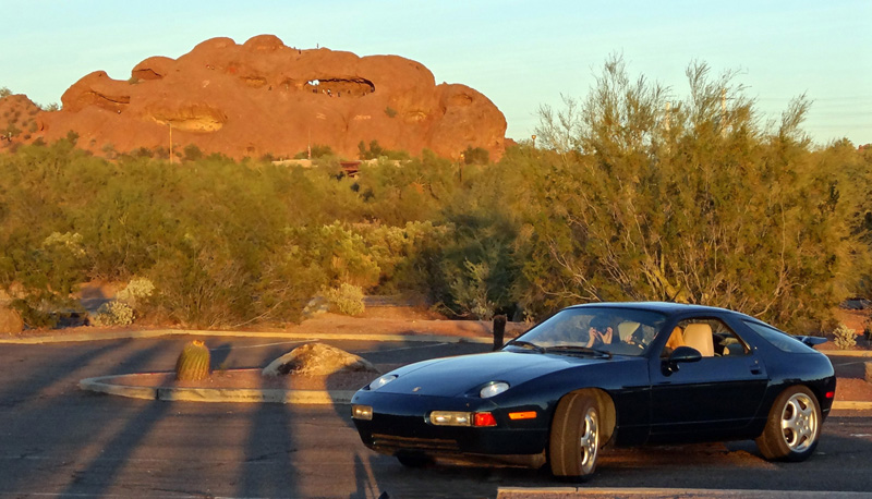

Learning that you are a Porsche enthusiast/collector and own a 356 I can understand how acceleration performance may not be a top issue for you. The early 928 is what was Prof. Ernst Fuhrmann and his team developed to save Porsche at the time because they feared the 911 couldn’t meet future safety, noise and pollution regulations. You ask a difficult question. I didn't include my 1993 GTS in my initial reply because that wasn’t a model in your consideration. I purchased my Amazon Green GTS (in my avatar) new.
It is my pride and joy and lives a pampered life. It is the culmination of the 928 as a GTS car. The power is superior to all, the interior is more luxurious. I installed a Porsche Classic radio to add some modern car features. Some may consider it sacrilege, but I sought out an automatic transmission during my purchase. The GTS has so much torque it normally starts in 2nd gear. On a lengthy drive, the automatic transmission shifts better than I do with a manual. So, I would keep my GTS. However, I actually prefer my 1987 S4 for road trips. It now has nearly 188,000 miles on the odometer, 60% of which I have driven since ownership. It has only had good maintenance and a transmission rebuild but the engine is original with no appreciable oil consumption. Some complain about the 2.2 : 1 final drive ratio of the differential, but I find the lower RPM at cruising speed to be preferable for lower noise and longer engine life. In comparison, the GTS has 2.538 : 1 (manual 2.727 : 1). For reference, the 1979 manual has a 2.75 : 1 final drive ratio.

I can see why your GTS is prized …..beautiful car !
