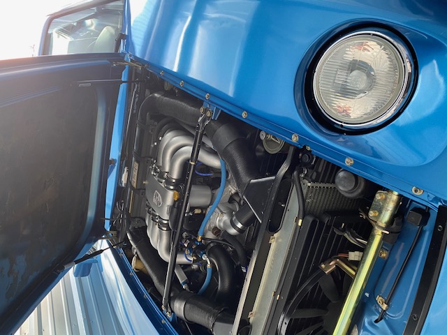

Hello all, my name is Ross, just bought a 1980 928S Euro 3sp auto. The car has been under mechanical restoration since 2010, I have boxes of documentation, thousands of pictures on thumb drives, every nut bolt and washer has been restored. The engine and related parts are so clean I'm afraid to drive it cause I'll never get it this clean again...it's art! I'm left with the body which is currently wrapped (homemade) looks great from a distance, and the interior is extremely ratty. The car is fitted with a MegaSquirt 3 engine management system...the program that runs it requires a university degree cause its heavily complicated. Look forward to sharing the rebuild with everyone and enlisting your experience....Cheers

Thanks Rich, each cylinder has it's own coil (COP) the coils are 2002 GM 1500 truck, the injectors are Bosch 24lb, By removing the distributor it really cleans up the engine compartment too. The MegaSquirt program is extremely complex and way out of my comfort zone as changing the wrong value can cause destruction
I would love to put the car on a dyno and see where the horsepower is. I'm currently getting the wrap off so I can have it painted (Minirva Blue Metallic)
I'll post as I go
