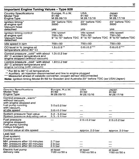

Have you made a smoke test (pressurized smoke forced in the intake manifold) to verify there are no vacuum leaks? Any leak after the airflow meter results in "false air" which results in a too lean air/flow mixture.
The L-Jet system has an air-fuel mixture set screw at the airflow meter. The exhaust stream before the catalytic should be analyzed and set between 0.4 to 0.8% CO, an exhaust analyzer is needed for proper adjustment. If there isn't an access port at the exhaust manifold before the catalytic converter, a bung hole and plug should be installed to access the exhaust stream. I had this done to properly set the air-fuel mixture on my 1979 Porsche 928.
Once the air-fuel mixture is set, the idle speed is set. There is a large screw at the throttle body accessed from the front of the engine that is turned for adjustment. The setting is 700 - 800 RPM.
The L-Jetronic fuel injection module requires an accurate input from the temperature sensor and airflow meter to function properly. Make sure that the vane inside the airflow meter moves smoothy.
I hope this helps.
