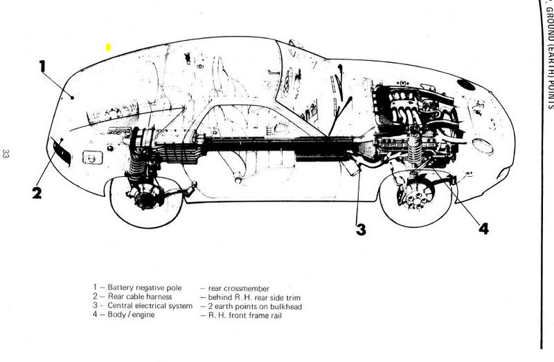

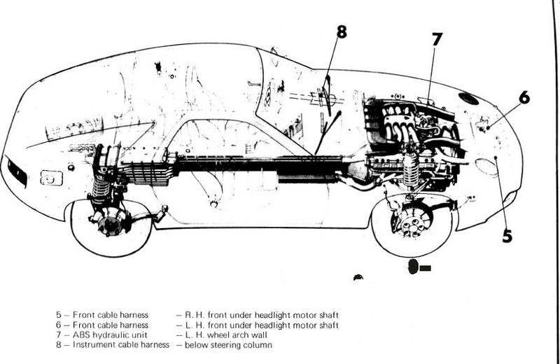

Some people pull the plugs and squirt Marvel Mystery oil in each cylinder and try to hand crank the motor to see if it turns, if it does, you can get a new battery, with new fuel, oil all set, and give it a crank. you can also check if power is getting from the battery to the front by checking voltage at the jump post front passenger side. if it isnt getting min 12V you will need to get to all ground points and clean the ground points as this will help with all kinds of fixes for electrical issues in the car.

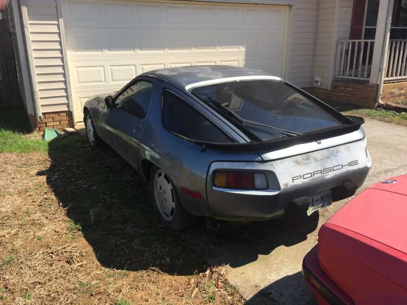

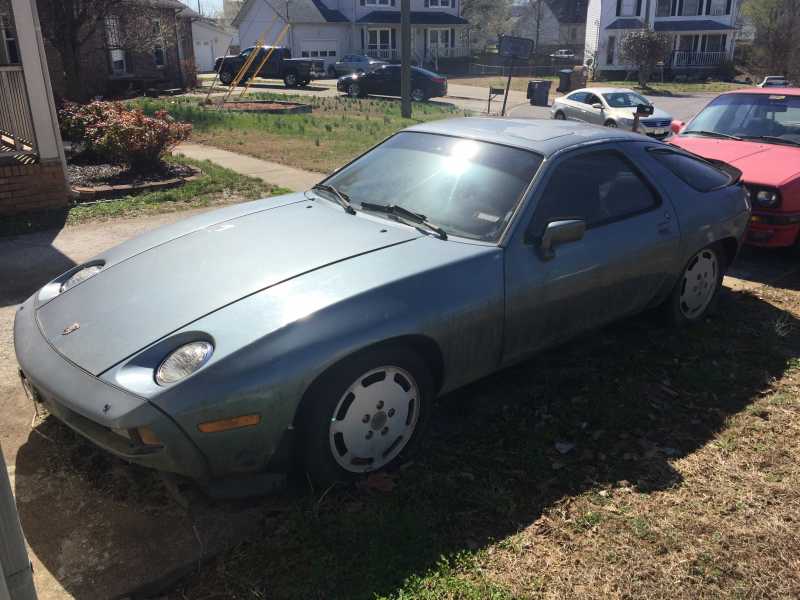

Bob , thank you so much for the welcome and advice. I definitely don’t want to go into this thing blind so I will probably become a member shortly. I know people will not believe me but I was given this car! and I’m thinking that it’s been sitting , it can sit a little longer , do it right and not break really expensive part. Never in my dreams did I think I would own a Porsche! Now if I could find a barn find 911!!! have a good day!
