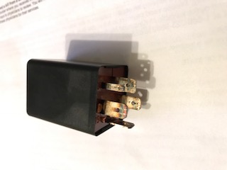

Replied by DennisFitz on topic New to the Houston 928 community - Car stopped running
Here is a picture of one of the relays removed. It shows significant “heat” damage. Hopefully this was the cause.
Took it out for short two-hour ride and a little. I could really feel the difference in the idle, and “smoothness” of the engine acceleration. It’s hard to put into words.
Thank you all for your help.
