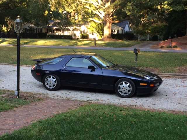

Thanks for the help, Derrick. I didn't even know that the hatch release mechanism was motorized, so I was pulling up on the switches as if it were some sort of mechanical mechanism. Now I'm certain that there's an issue because I don't here any type of motor mechanism at work. The previous owner had replaced the plastic catch, so at least it opens and closes well with the key. I'm happy to leave it at that for now but will peel back the carpet and clean the connections at some point.
It took me a few days to find the time to get to the county tax office and the DMV, so I just got the plates on today and was able to drive around town without fear of being stopped for that.
I'll put up more pictures later, but I attached a quick pic I shot with my phone from the driveway.
