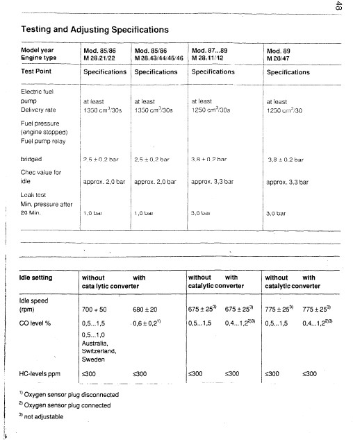

Power cutting out could also be a symptom of failing relays. If the relays for the fuel pump (XX), EZK spark (XVI) and LH (XXV) have never been replaced, I suggest replacing them. there is also a fuel pump fuse (#42) that if the connection is corroded could cause problems.
Generally, a failing Porsche 928 fuel pump will be much noisier than the low hum sound of a good one.
I suggest checking the fuel pressure and delivery. Note, for the S300 chip installation use the fuel pressure for the 1987 and newer 928 S4. Low flow could be caused by a clogged fuel filter or missing screen at the in-tank fuel strainer as the fuel filter is after the fuel pump.
Testing the fuel pressure is done with the engine not running. It requires removing the Fuel Pump Relay (XX) and placing a jumper wire between socket positions 30 and 87. Listen for the pump noise before checking fuel pressure.
Your 1985 - 1986 Porsche 928 requires setting the base CO% and idle speed for the lambda air/fuel regulation and idle speed regulation to work properly. See the factory workshop manual for the procedure. A CO% exhaust test is done before the exhaust reaches the catalyzer (setting is 0.6% plus minus 0.2 and less than 300 ppm HC). The CO% adjustment is done by turning the adjuster at the MAF.
