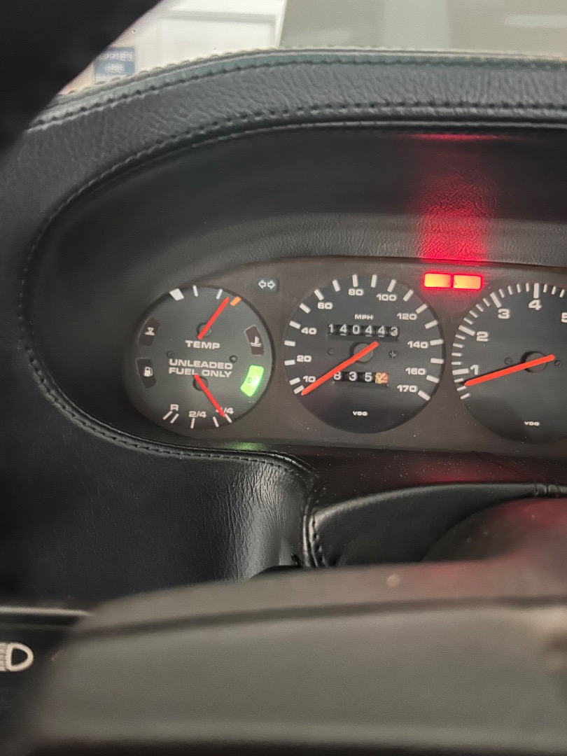

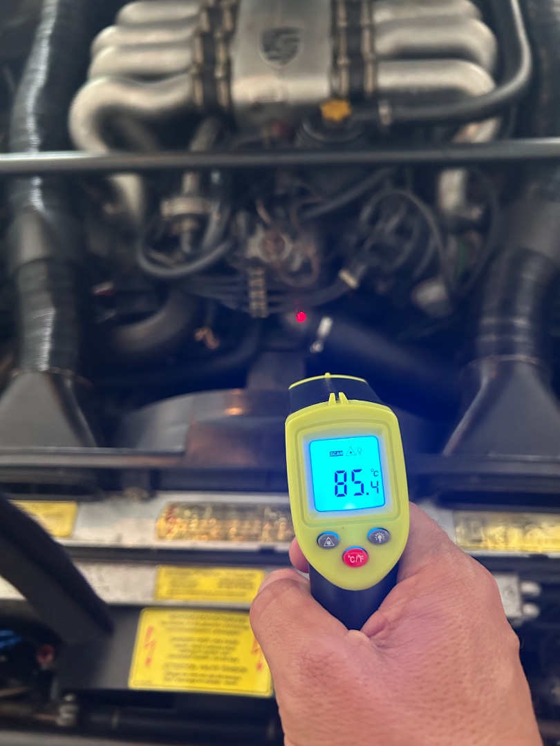

Hi all. My car runs with the temp gauge at the second white line while under way and creeps up towards the red line when at idle for a period of time (traffic). However the temp readings at the water bridge are always within range.
I have a fairly new radiator and fan clutch. The temp sensor on top of the water bridge measures correct resistance. I’ve recently installed the fan on when ac on wiring kit I got from Rich and it works great. Seeing the needle go up that high does give some anxiety even though I’m pretty sure the temp is fine. Would this be a problem with the gauge itself? I have serviced the cluster and it has a new circuit foil.
thoughts on this?
thoughts on this?

My 1979 928 reacts exactly as you describe. I have a new radiator, have replaced the viscous fan clutch and have the "aux fan on" with A/C. On a cold day when the thermostat just opens the temp gauge is around 1/2 position. Normal operation on a summer day is at the second white line. On hot days (Arizona 105F and above) and in traffic the gauge will slowly rise towards the red. At this point I turn off the AC, run at a 1,000 RPM speed and it usually will stay just below the red zone. Once I get moving the needle moves back down to above the 2nd mark ... it is repeatable.
At no point is the water boiling and the IR gun doesn't show overheating. I've heard stories from old 928 owners who purchased the cars new who said "those cars always ran hot." It cold just be the gauge calibration, it could be old wiring. IMHO as long as you stay out of the red you're OK.
My 1987S4 and 1993 GTS with the electric fans have no issue with summer heat even with the A/C on.

Thanks yall. Since posting I tuned up the K Jet and it’s running better AND cooler. I also added Redline Water Wetter and decreased the ratio of antifreeze to water. Stays below the second white line and creeps up to just over when it sits. Cranks right up any temp and feels SMOOTH!
I did discover that when hot my temp sensor measures too low of a resistance even though it reads fine when cold, so that might be causing a high reading on the gauge. Gonna replace that and the fan clutch as it doesn’t have much of any change in physical resistance when turning by hand hot or cold.
Parts arrive beginning of this week and I’ll report back once in and tested out.
1 year 1 month ago #22986
by drjustin
Replied by drjustin on topic Temp gauge readings 78 manual
After replacing my temp sensor and fan clutch here are my findings…runs about the same! Just like Rich said actually. With the new temp sensor the needle on the gauge rose to its usual spot, but with an added bonus of the coolant temp warning light coming on prematurely. I put the old one back in and will return the new one.
Probably didn’t need a new fan clutch either but at least now I know. The new one seems to have about the same resistance when turning the fan by hand as the old one. At this point I think I’ve covered all the bases and I’ll try to stop obsessing over the gauge reading and enjoy the driving!
