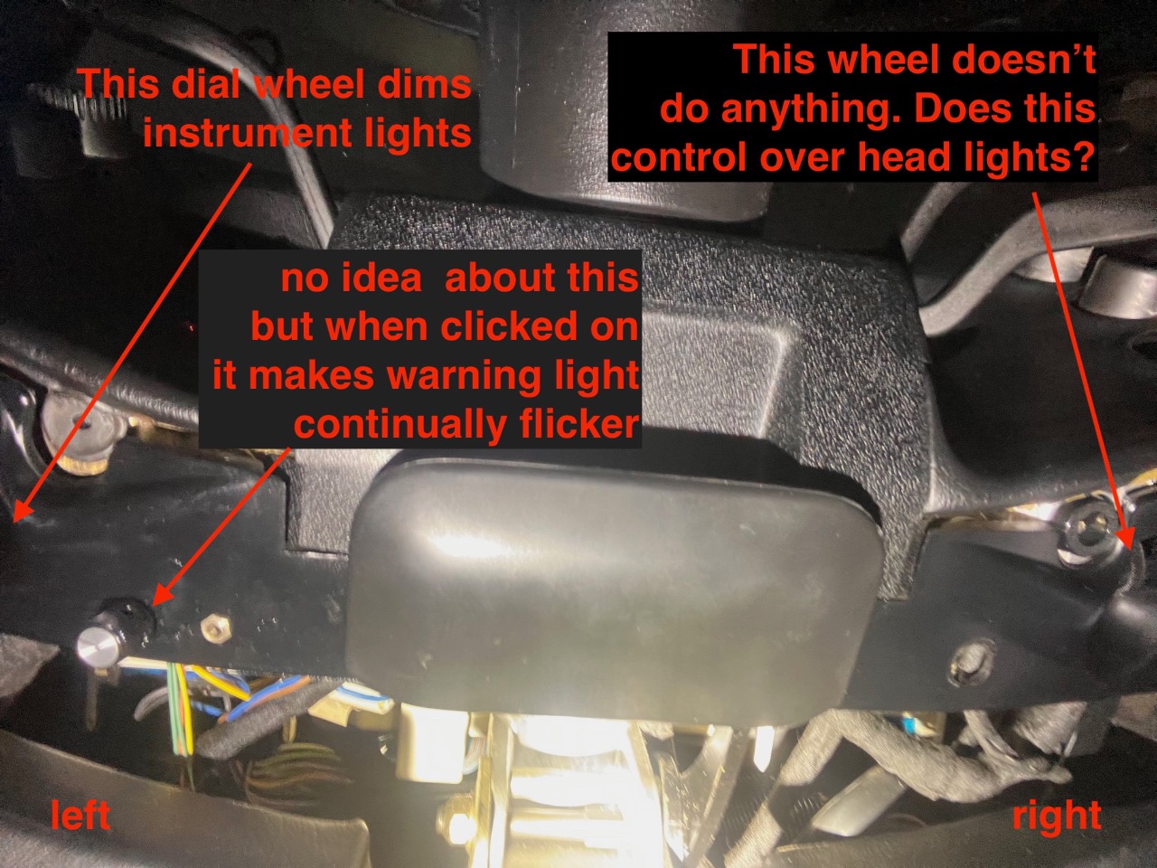

Thank you guys for taking the time to help a new owner. The bulbs are good. Attached is a picture under dash. Seems I saw where someone cleaned the dial wheel to fix their problem? Does the right dial wheel control the overhead lights? any idea of what the twist knob is?

The one wheel does the instrument lights, the other is for the intermittent windshield wiper, changes how often the blades move.. No clue what the other knob is, perhaps something after market.
