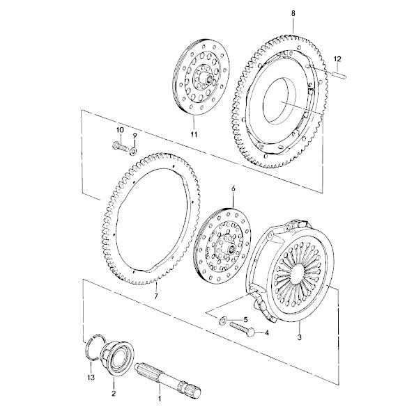

If you need to have further service, the Porsche 928 clutch is relatively easy to remove, the torque tube doesn't need to be removed as in some other cars. The diagram above shows the components. Item #1, the central shaft, should be inspected. It and the clutch plates may just need to have the splines cleaned so they can smoothly move. Worst case it may need to be replaced. The clutch release bearing (aka "throw-out bearing") should be replaced if you open it up.
Replied by Rich928 on topic 1984 5sp Won't Enter Gears
