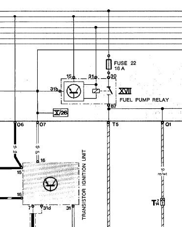

This fuel pump relay is P/N 928.615.113.01 (available superseded P/N: 928.615.113.03).
The transistor Ignition Unit RPM output signal 15 connects to central electric fuse panel O7 which connects to Fuel Pump relay terminal 31b. This signal is also used by the tachometer display in all model years to US 1984 L-Jetronic and model year 1978 – 1979 Air Conditioning Compressor Relay.
The fuel pump relay will not turn on (switch closes) until the engine RPM reaches cranking speed (~50 RPM). When the relay turns on the circuit from the 30 (12V connected directly to the battery) to the 87 that connects to the + terminal of the fuel pump and the fuel system is pressurized. If the engine stalls due to any reason, the fuel pump will turn off. This is a safety measure.
The connections to the fuel pump relay P/N 928.615.113.01 are:
15 = ignition switch turned on
30 = direct connection to battery, always battery voltage
31 = ground
31b = engine RPM signal
87 = switched output, circuit to fuel pump + terminal

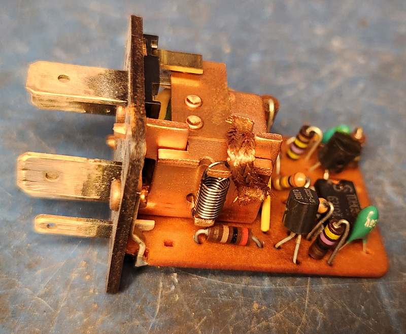

Standard relays do not have an RPM signal input or logic to control relay “turn-on/off” based on RPM. I suggest replacing fuel pump relay if it has never been replaced or the replacement history is unknown. This relay currently is available to purchase, however at some time the production could be discontinued. Even though the relay is available, only Porsche dealerships or focused part vendors stock them so it may take days for a replacement part to be delivered.
31 = ground

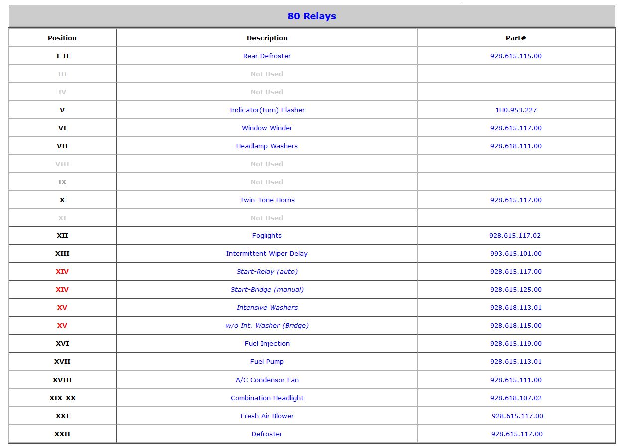

But I had a couple relays that worked (Not for FI system used the 30-87 jumper. I got the car running. At first no NOID, but I repaired that. As soon as I got noid she fired on an ether shot. Then after that it ran on it's own.
>> Good job! The L-Jetronic sytem requires two special relays (a standard relay CANNOT be used), therefore they need to be purchased an installed:Fuel injection (AKA Airflow) Relay Part Number: 928.615.119.00Fuel Pump Relay Part Number: 928.615.113.01 … this relay receives an RPM signal from the TSZ spark box and only turns on with engine cranking RPM or greater.
