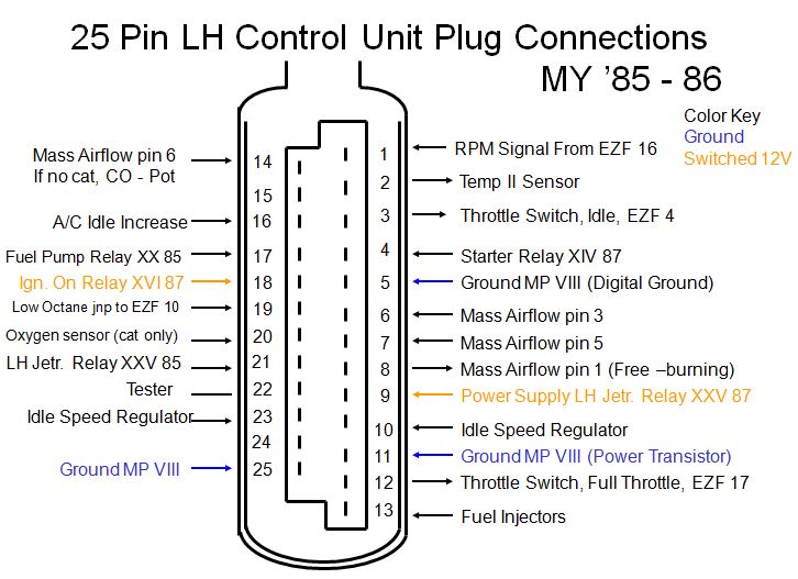

Note, the horn relay is the same part 141.951.253B as used for the LH, EZF and fuel pump relays.
Have you checked the LH Relay XXV, put a jumper between 30 and 87 to see if it will start.
The fuel pump relay in 1985 - 1986 928s energizes the fuel injectors. It is turned on by the LH fuel injection module (ground to relay) only when the engine is cranking for start or running. Double check that this relay is functioning.
The LH fuel injection module requires an RPM signal from the EZF spark module. Check the circuit between LH connector pin 1 and EZF connector pin 16, if it is an open or shorted to ground circuit repair the circuit. This same circuit provides the RPM signal to the tachometer, so if it has failed with a short to ground that can cause a no-start condition.
If you continue to see no fuel injection pulse, the LH fuel injection module may have failed. I can test it for you.

Hello again Rich928. I finally got the flywheel sensor out and yes it was a TOTAL B%&$. When you say check #1 and #16 am i checking voltage? Do I have key on for this?
