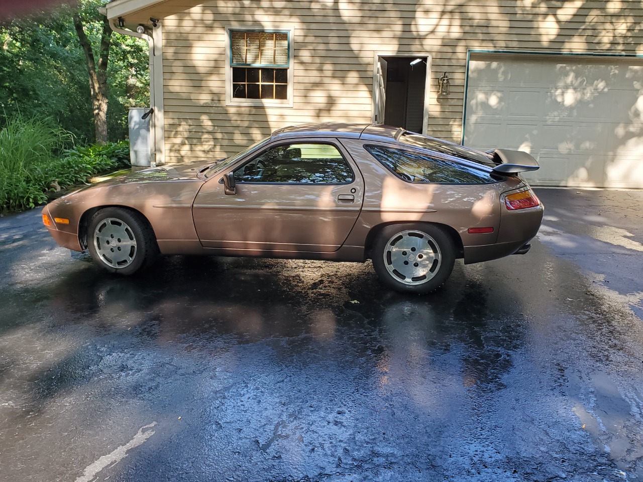

Bringing my 928 back to life after 10 years.
2 years 5 months ago #22627
by mrzip2009
Bringing my 928 back to life after 10 years. was created by mrzip2009
