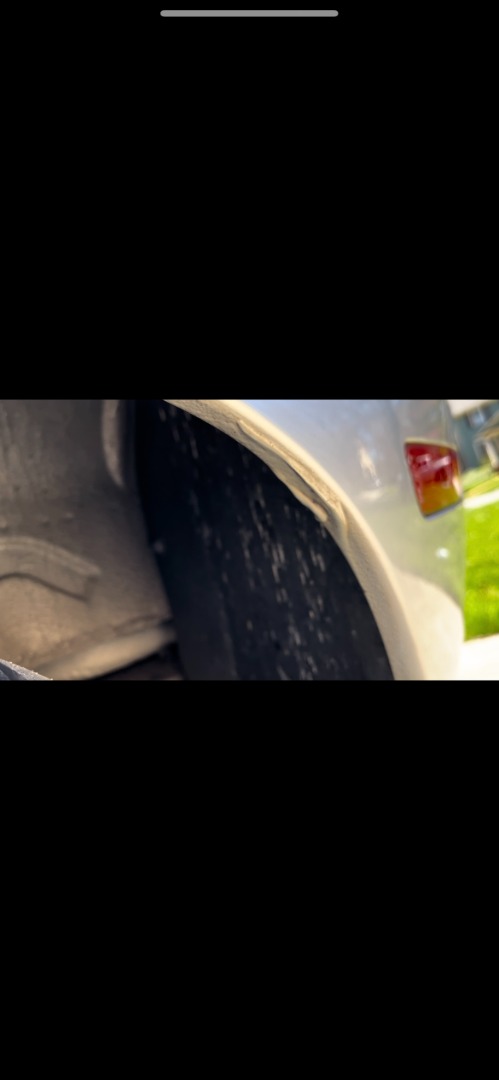

2. I've attached a picture of driver's side rear fender wheel well, looking towards the back of the 928. The fender 'lip' is rough, looks like a defect. The long-term owner claims no body work ever... could this possibly be original, from the factory? It really seems out of character with the rest of this original 928.
It could be as simple as some sealing compound was sprayed during assembly and it was painted over. Is the material hard or soft/spongy?

Fender lip… it’s hard compound. To me, it does look like sealer, possibly applied at factory. It seems like a big quality miss if that’s true. If it’s a poor repair, it seems out of character with the rest of the car.
