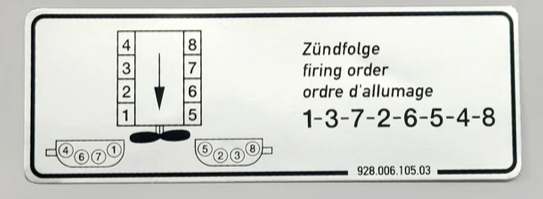

Hi everyone, I could use some advice. I bought a running and driving 86.5 S last May and really enjoyed cruising around in it all last summer. In the winter I decided I’d better do the timing belt and water pump. I bought the kit from Roger including the porken tensioner and followed the steps word for word. While I was at it I also removed the air pump and catalytic converters and replaced the O2 sensor because I’d like to track the car this summer. Well, after getting everything back together I turn the key and it fires once then sits burbling while I crank. I double and triple checked the order and connection on the spark plug cords and the connections to the Bosch cans on each side, I can’t remember their names at the moment. There was a loose ground there so I reconnected it and still does the same thing. It’s getting fuel because after trying to start it for a few seconds I smell gas. I haven’t tried testing any relays yet, I’m hoping I’ve forgotten something simple but I can’t find what it could be. Any and all suggestions welcome. Thanks in advance!

Post some pictures, it sure sounds like the ignition leads are not set up correctly. Hand crank to TDC and check through the vent holes if cam gear notches are lining up or not. Did you take pics during the work?

I’ve gone over the firing order several times and the wires look pretty new, although I will check them for arcing. The more people I talk to the more I think one or both of the cams is off by a tooth.
