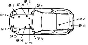

Don't overlook checking all the ground points on the chassis. There is one behind the central electric (fuse) panel. Take the fasteners loose that hold the panel in place and look behind it. This diagram indicates the ground points on your 928 GTS.

I got some time this morning and replaced the 3 relays and checked all the ground connections. Thanks for the diagram. They all looked fine.
