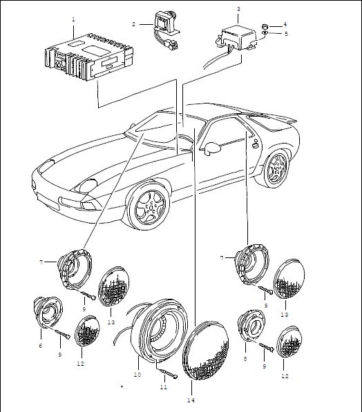

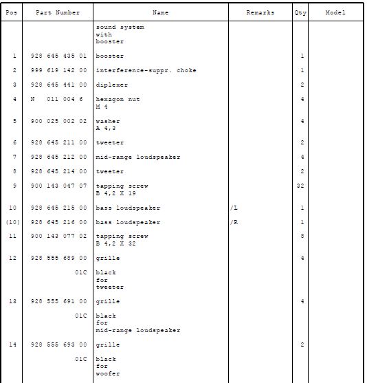

So I am looking to add all OEM 10 speakers that came with the 95 GTS. What would be the best way to hunt these down? Any recommendations as to what you would do?
3 years 4 months ago #22412
Replied by Rich928 on topic 10 Speaker System in my 95 GTS, WWYD?
These are the speakers and part numbers. They are likely no longer available from Porsche. You may be able to locate used speakers from a dismantler or similar sized speakers from an audio specialist.
