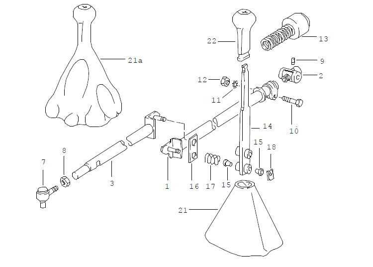

I also suggest checking the bearing body 928-424-029-00 (# 2 in the illustration) which is what connects to the shifter shaft at the front of the transaxle.
The angular joint 928-424-005-01 (#7) at the rear of the bell housing is what was previously mentioned. [attachment=1413]Angular joint socket.JPG
