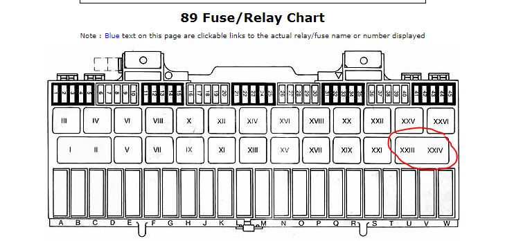

5 years 9 months ago #21742
by nluk100
'89 928 GT
Replied by nluk100 on topic Headlights
First place to look is the headlight relay - can you hear it clicking when you turn the dipped beams on?
