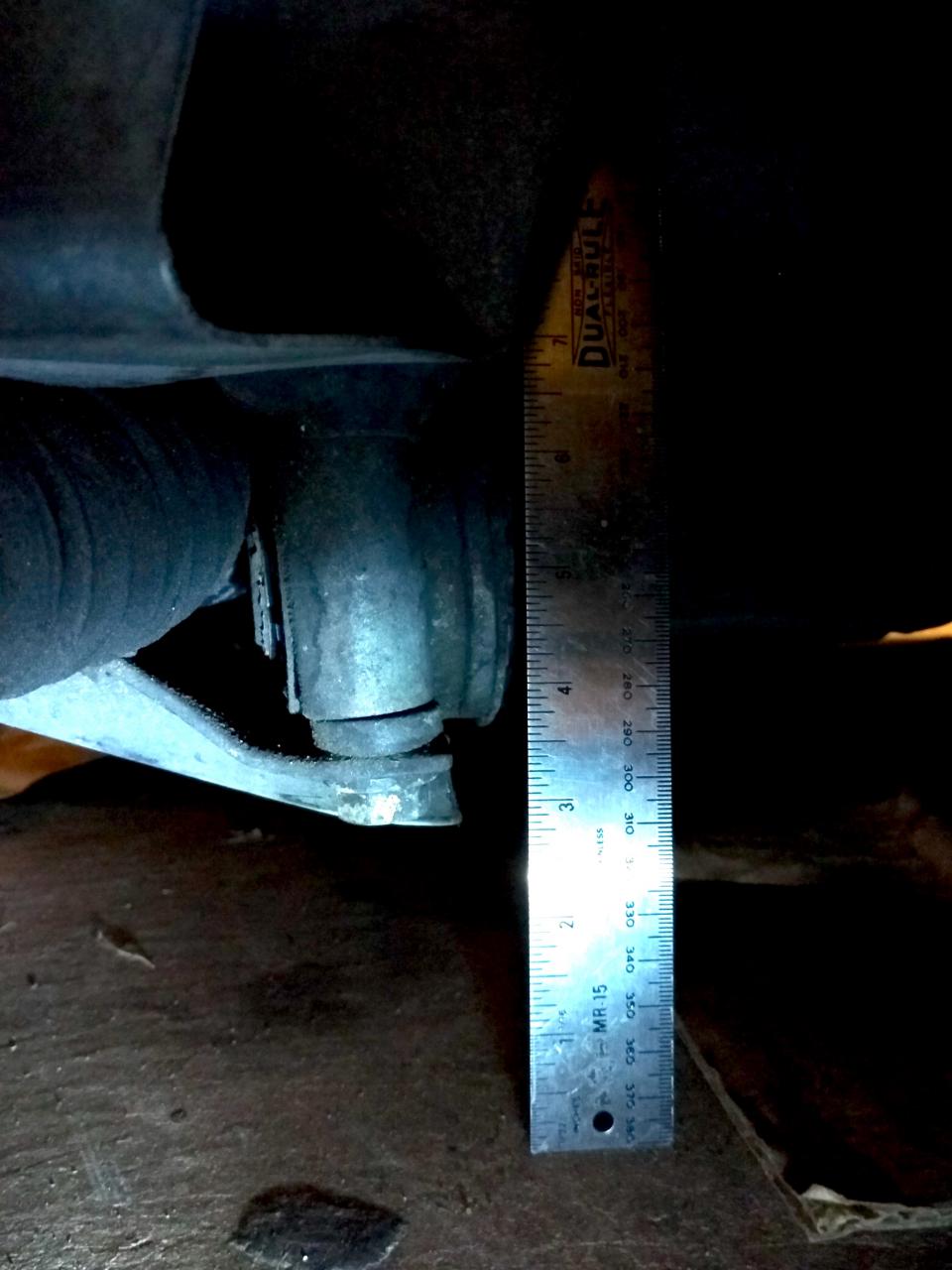

I am wondering of this upgrade does raise the front end as well. My '84 928 is very low and wanted to try and raise it a couple of inches if possible. My initial thoughts are shocks, springs and tires. I just took a picture of the left front end and one can see it is about 2-3/4" off the ground.
Ideas and comments appreciated.
/Users/dariorodriguez/Desktop/LeftFrontEnd.jpg
