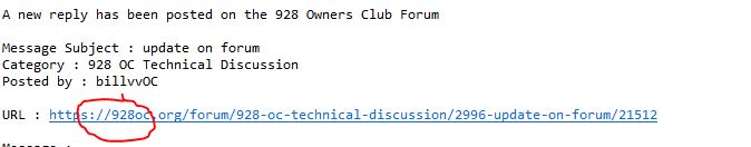

Yeah, I had to add www to mine to get it to work - you need to edit your .htaccess file to fix this issue.
This is what I get in my forum reply emails.

The .htaccess file looks OK, but what do I know?.......
RewriteCond %{HTTP_HOST} ^928oc\.org$ [OR]
RewriteCond %{HTTP_HOST} ^www\.928oc\.org$
RewriteRule ^/?$ "http\/\/www\.928oc\.org" [R=301,L]

I don't think that's correct - you need this code to add www to all requests;
RewriteEngine On
RewriteCond %{HTTP_HOST} !^www.928oc.org$ [NC]
RewriteRule ^(.*)$ www.928oc.org/$1 [L,R=301]
I sent you (or whoever looks after the moderation) a separate note re: helping you with the website/forum - did you not get it?
