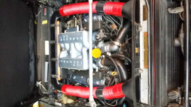

What I've done is wrapped my intake tubes in aluminum-coated bubble wrap and metal tape. It seals them up and insulates them from the high engine temperatures and makes the running temperature of the engine drop significantly. Sounds kludgy but it really works!!

Aluminum bendable dryer vent tubing

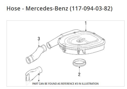

Replied by Rich928 on topic Air Intakes Tubes
Mercedes Benz hose part number
117-094-03-82 tubes will fit. You'll need two per side (total of four).
