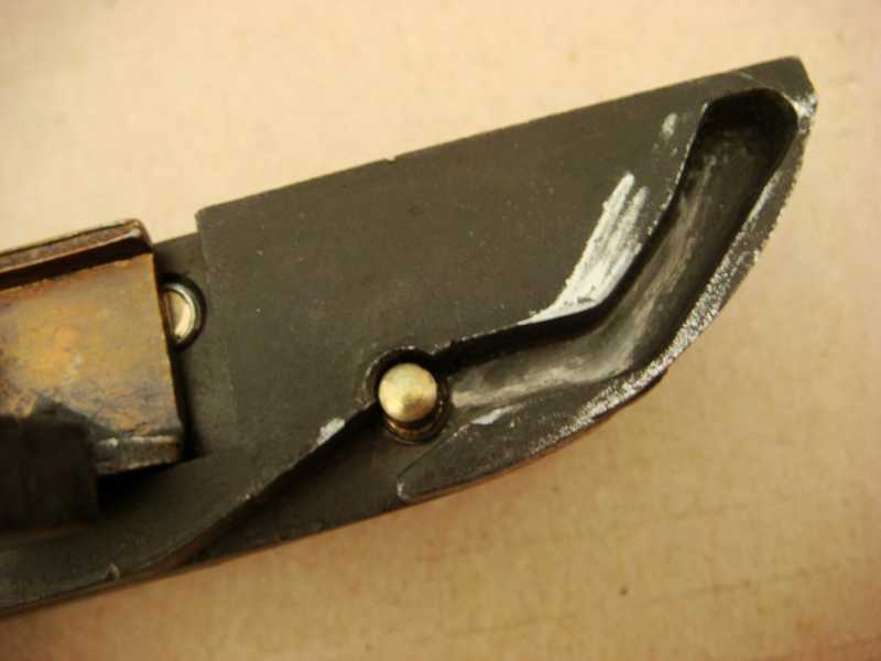

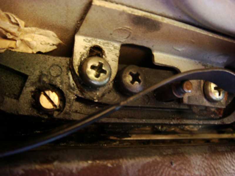

I am sorry, I must be a little thick. I have had the car for a month and did not plan to do any home maintenance until the conditions were right. I accidently pushed the sunroof button and it all went spiralling into a mess.
“your sunroof is closing all the way but it does not go up in the rear is a simple adjustment” - Yes
“slide the roof back and take out the three screws that hold the sunroof headliner on the sunroof, then remove the headliner by pulling it forward and take it right out. Once removed close your roof again.” Done
“on the sides of the front of the sunroof you will see the adjustment screws for the tilt mechanism of the roof” – Are these the gate guide – 928 564 045 42?
“they are more than likely loose, but if not loosen one side at a time, push your roof up in the rear and tighten screw while holding sunroof in up position, simple adjustment”
This is where it gets confusing….
1. the gate guide (while the sunroof is closed) do not appear to be connects to anything (aside from the little tab on the other side). As the photo shows the sunroof it at its max upward extension on the rear tab…so I am confused.
2. There is a small screw on the rear of the guides. On the other side is a groove that does not appear to be connected to anything?
3. I can push up the rear of the sunroof, but the guide appears to do nothing.
It is now raining and I have no garage and life is getting more difficult….
Dan
