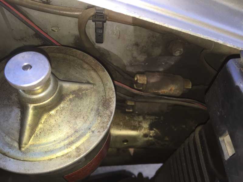

What are those items in the Picture?
11 years 7 months ago #18040 by dumptruck
What are the 2 "things" pictured, to the right of the power steering fluid reservoir, that are parallel to each other attached to the left side of the engine compartment?
As I was hunting down some electrical issues I found they were alarmingly hot to the touch? Thank you!
Dumptruck
11 years 7 months ago - 11 years 7 months ago #18045 by joejabq
They are 0.4 and 0.6 ohm resistors for the ignition system. They are described in the following:
members.rennlist.com/sharkskin/Pages_Mai...nTroubleShooting.htm
