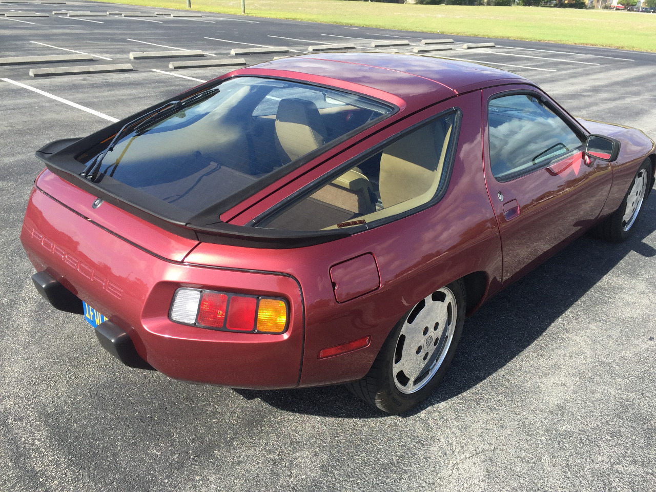

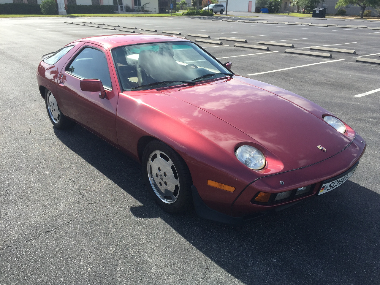

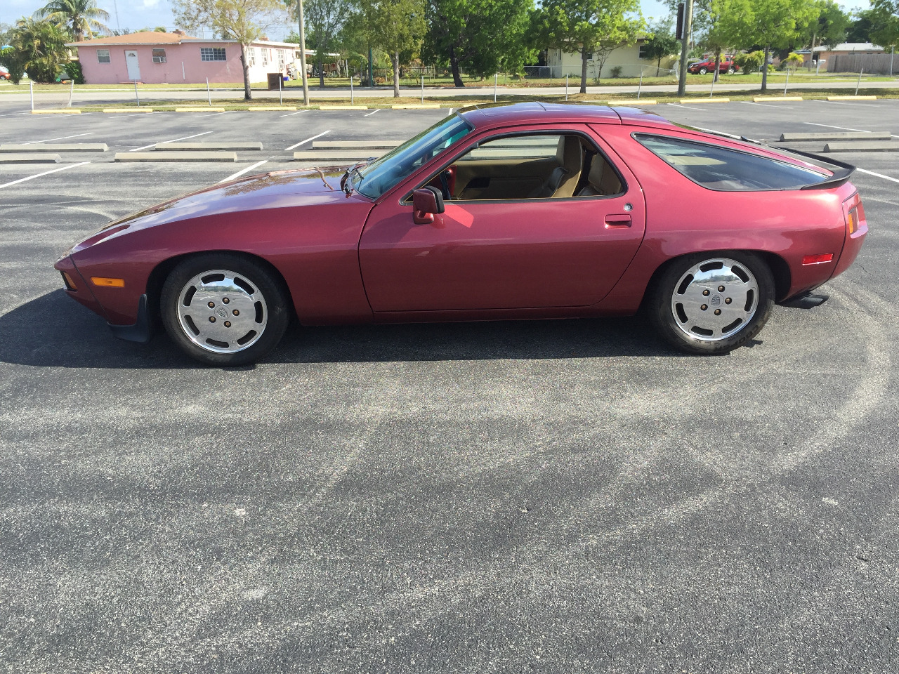

I have a 1982 928S California Special and I am wondering how was the California Special any different for the non-California one?? Also how can you tell the difference between the Euro spec model and the US model? Anybody out there up to speed on these variants?

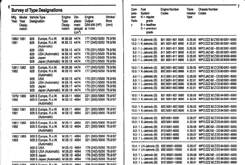

You asked how to tell the difference US and Euro-spec model. I can help with this question.
Up until 1987 there were differences between US/Japan and European/ROW models due to emissions requirements and the use of unleaded fuel. For the US/Japan markets beginning with 1980 through 1984 model years the fuel injection used was the L-Jetronic system with an O2 sensor and lambda air/fuel regulation with catalytic converters.
The European/ROW cars used a Bosch K-Jetronic mechanical continues injection system through model year 1984. For model years 1980 - 1982, Porsche offered the base M28/09 and M28/10 engines with 229 HP and an S model with the 300 HP M28/11 and M28/12 engines. In 1983 all European/ROW cars were fitted with the 300 HP engine. Beginning with model year 1984 the engines were upgraded to a digital Bosch LH fuel injection and produced 310 HP. In model year 1985, the US cars were upgraded to a 32-valve 288 HP engine which used an upgraded Bosch LH fuel injection system.
There also were various differences such as final drive ratios between US and European/ROW models.
Up to model year 1987 (the 928S4), all the US spec 928s were fitted with 7 inch US DOT spec sealed beam headlamps. All the European models were fitted with 8 in. H4 headlamps.
If the car in the photos is yours, it appears someone upgraded it with 8 in H4 headlamps.
The table below provides a lot of information about the various year models.
